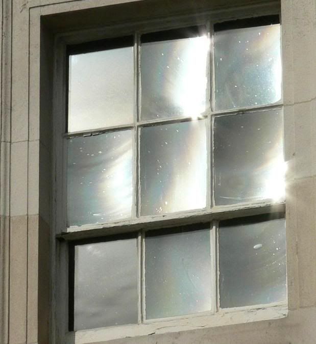

On the subject of old glass (which just came up on the Pearse Street thread), Trinity College are refurbishing all of the sash windows in the Front Square of the college at the moment. That’s fine, but a lot of old glass is being lost during the work. And, worse, I believe they’re using fake-old glass in place of destroyed actual-old glass. The whole of the northern block of the square has been completed so far.
Almost all of the windows in Front Square are the original 1760s ones (apart from a few in the centre of the College Green block, which had been replaced with plate-glass sashes 100 years or more ago, then replaced back to multi-pane sashes again in the 1960s) and they contain a lot of old glass.
Here are a couple of panes of incredibly old crown glass (in the top left of the sash) in Front Square. The circular pattern indicates that they were cut from a disc. This type of glass stopped being made in the middle of the 19th century, so these panes are at least 150 years old.
Then this is the more commonly-seen old glass, called cylinder glass, made from the mid-19th up to roughly the mid-20th century (when it became possible to make perfect, blemish-less glass). It is ripple-y and often contains pock-marks.
This is one of the sash windows that has already been refurbished in the north block of the square. There are no panes of old glass left except for the one on the left in the middle, which I believe to be fake-old, as it has a different appearance; it’s really just a normal pane of glass with deliberate ripples.
I’m going to try and speak to the Conservation Officer about this, because it is not really acceptable that irreplaceable historic hand-made glass is being destroyed and possibly replaced with pretend-old glass in a key historic institution of the city like this. Trinity’s original sash windows & old glass are famous – they appear on the front of a book on the history of Irish windows and glass by Nessa Roche.

Indeed they do, and of course Craig makes reference to the Library windows also, however I wouldn't be quite as quick to jump on Trinity. Roche's book, as fine a publication as it is, doesn't quite explain enough the variety of methods used, nor the popularity of certain types of glass, especially in Ireland - many references are made to UK glass or their methods that were imported, but with little expansion on their extent of use here.

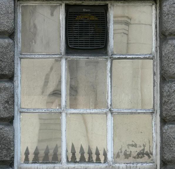

The broad characteristics of crown glass and later glass such as cylinder and plate are very well explained, however the precise methods used in manufacture and more importantly the quality of output is not fully entered into. I'm no expert, but have come across countless examples of glass that cannot be neatly slotted into the categories as set out in the book, glass that looks like poor quality crown or high quality cylinder, glass that has both swirls and dimples, glass that has a highly dimpled surface, and glass that is much less blemished - all in a host of 19th century buildings of many ages.
Even comparing two images, look at the difference in quality between this and this - both supposedly cylinder glass:
Presumably Trinity is early cylinder or 'broad' glass, while Pearse St is a later improved version (?)
Admittedly your other pic does look dodgy Devin, but that could just be a dodgy pane of crown - it's hard to know. I find it hard to think that Trinity would replace what even it recognises as one of the great treasures in the city with poor reproductions. The conservation project thus far looks like a job well done, even if the giant Venetians look a bit chunkier than usual now. You can certainly see the acres of priceless crown in the College Street window anyway!

Yes, I was being quite blunt in my categories - there is of course a lot of variation in all types of glass. I don't read much on it. I really just pick up what I know from observation.Graham Hickey wrote:The broad characteristics of crown glass and later glass such as cylinder and plate are very well explained, however the precise methods used in manufacture and more importantly the quality of output is not fully entered into. I'm no expert, but have come across countless examples of glass that cannot be neatly slotted into the categories as set out in the book, glass that looks like poor quality crown or high quality cylinder, glass that has both swirls and dimples, glass that has a highly dimpled surface, and glass that is much less blemished - all in a host of 19th century buildings of many ages.
Shocking as it is, that seems to be exactly what’s happening. I was just looking at that magnificent Venetian facing College Street earlier today, and there isn’t, I believe, a single pane of actual old glass left in it. Most of it now is modern glass, with a few panes of, I’m sure, fake-old glass.Graham Hickey wrote:I find it hard to think that Trinity would replace what even it recognises as one of the great treasures in the city with poor reproductions.
It’s quite incredible how this could have happened. The refurbishment of the windows is about one-third complete now, possibly a bit more. All of the College Street façade has been done - including both Venetians at the front corner - and also the windows of this block which face into the square, and they've now moved onto the southern block (havr just begun).
The planning reference for the work (which also included a lot of internal refurbishment) is 5947/04, and it was granted permission last July.

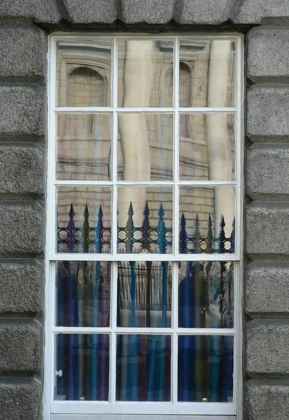

Some of the Trinity windows below. The majority of the West Front’s old panes, certainly in the non-restored windows, seem to be an early form of cylinder glass, with that typical wrinkled and warped texture like the skin that forms on hot milk:
The only pane of 1750s crown glass above is that in the very top right corner with the very apparent swirls.
The crown glass featured in ‘The Legacy of Light’ seems to be the exception rather than the rule right across the entire 1750s Parliament Square complex incl the West Front. Many non-restored windows also appear to feature quite an amount of modern glass too, though it’s difficult to say how much such was the light at the time. This un-restored W F window seems to feature nearly all modern glass, with only two single panes of cylinder in opposing corners:
Otherwise though, un-restored windows with lots of modern glass do not seem to be that common.
This restored window on the W F features entirely modern glass which is very wavy in appearance, with the exception of a single surviving cylinder pane in the lower sash.
All of the other few windows that have been restored here so far also seem to feature lots of this strange glass. I don’t know if it was here before the restoration. Here’s another example, though this time a lot more cylinder:
Moving inside to the Front Square and the northern block, and again a mixture of cylinder and modern wavy stuff in this restored window:
Pretty much all of these windows in the northern wing feature exactly the same mixture of modern wavy and old cyclinder. No evidence of crown at all. Many of the upper windows in the northern block also feature 1830s horns which might explain the early cylinder in the older sashes below such as that pictured.
So all in all, a difficult one to call without examining all the glass exceptionally closely. There appears to be a difference between very flat modern glass in some windows and more wavy modern glass in others as pictured. If this difference could be confirmed, and the wavy glass distinguished as being only in restored sashes, then there could well be something fishy going on. Either way that wavy modern stuff isn’t very attractive – gives the impression of bendy plastic sheeting. Still, it does seem all of this was there before the restoration, and in the windows I looked at I didn't come across any really dodgy stuff like that you pictured Devin.
Admittedly crown can look like plastic too in certain light – here’s some lovely stuff surviving high up in the side elevation of the Chapel. Note the blatently modern pane in the top left and the cylinder pane in the bottom left:
Also some stunning cylinder above the central doorway of the northern block:

Yes, most of the remaining old glass in the not-yet-restored windows of the West Front (and its rear, and the east block) is cylinder, with a lesser amount of crown – not surprising as it is a much older method than cylinder.Graham Hickey wrote:Some of the Trinity windows below. The majority of the West Front’s old panes, certainly in the non-restored windows, seem to be an early form of cylinder glass, with that typical wrinkled and warped texture like the skin that forms on hot milk:
It would be tragic to lose all of this, but, imo on the evidence of the restored northern block, that’s exactly what’s going to happen unless the situation is intervened upon.
(As you say some windows don't have that much old glass - just a couple of panes - but overall there is a fair bit left, especially in the upper floors.)
I can’t agree with you here Graham. As far as I would be concerned the ‘cylinder’ you refer to is ‘fake old’ glass. It’s some type of agricultural glass, used perhaps for greenhouses and the like. It is used because it looks a bit like cylinder glass. It is just rippley]very odd [/I]pane of genuine cylinder seems to be surviving the restoration (there is one in the middle right of the above pic), but certainly none of the rare and more valuable crown.Moving inside to the Front Square and the northern block, and again a mixture of cylinder and modern wavy stuff in this restored window:
I’m pretty sure the ‘wavy modern’ or ‘bendy plastic sheeting’ (good description!) glass - which makes up the majority of glass in the restored windows - is also new; it looks new and it doesn't seem to exist in any of the not-yet-restored windows. As you hint, perhaps it is intended as a (crap) imitation of crown glass?
This also, as far as I would be concerned, is the ‘fake old’ glass.
So, in short (I think), all of the former very-flat-modern / cylinder / crown glass of Trinity’s windows is being replaced with a combination of wavy-modern and fake-old glass, with maybe a very small amount of genuine old being saved and reinstated.
The reason for this I reckon is - just like so many things in Dublin at the moment - a need for speed … the number of windows to do versus the contract deadline; when they’re dipping the windows, removing the paint, splicing in new wood etc. it would just take too long to remove the old glass without breaking it … easier to just knock it all out and put new glass in when the work on the sash frame is complete …
The job is proceeding apace. As I said earlier, having completed the northern block, they’ve now moved onto the southern block, and in the last couple of days, a load of sashes have come out of the 2nd floor of the square facade to be taken away for ‘restoration’.
I’ve spoken to the DCC Conservation Officer and also a DoE conservation official and the situation is going to be investigated on Tuesday. Will update.

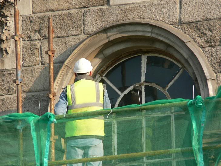

Yes the southern block is underway now - which means they'll spread back out onto the southern West Front before long where there seems to be a good amount of crown remaining. Here's the southern Square block now with removed windows as mentioned:
Also the giant southern Venetian on Colleg Green being restored back in January:
(thought I'd better airbrush out the contractor's name
Work was only getting started above, so there'd be no evidence of glass replacement here either way.
